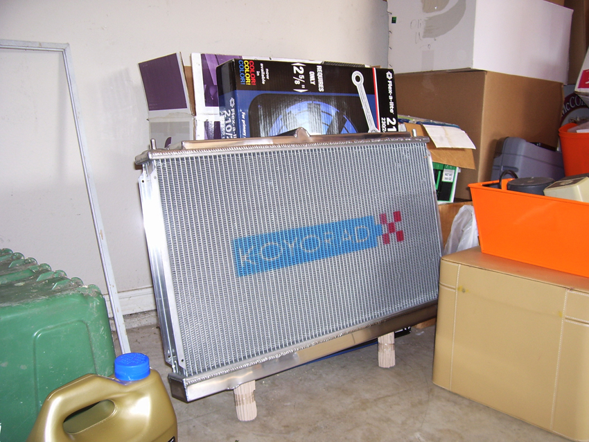

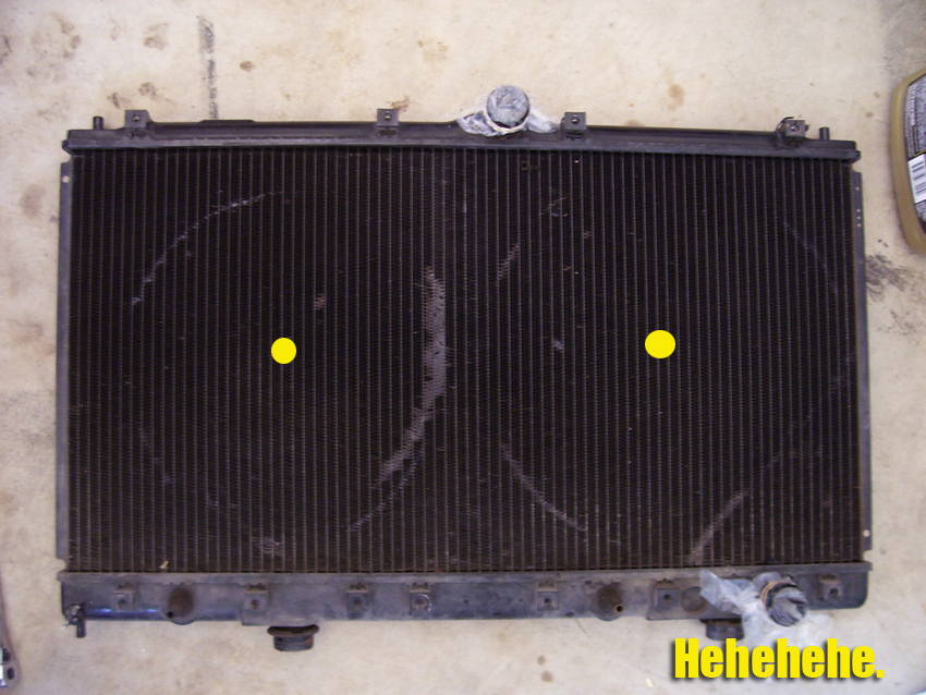

My new radiator came in yesterday. So today, I was able to work on my car. :cool:
Time to get started.

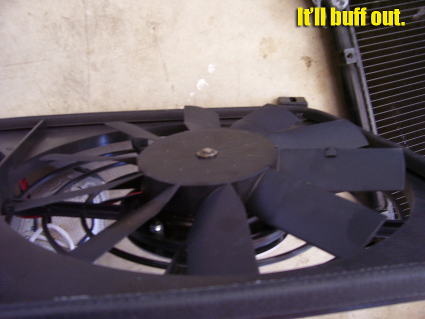

First up was to pull the old radiator and messed up fans.
I'm not sure if this picture is WS. :eek: :lol:
Holy Cow!!

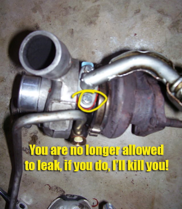

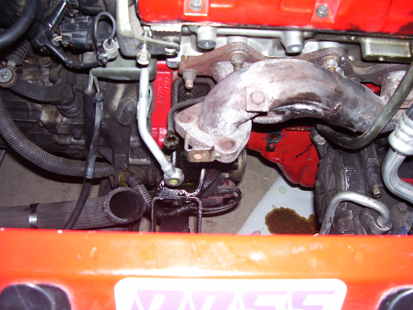

Also, my front oil return line has been seeping oil for a while now. Since I have to pull the turbo to fix this, no better time than now.
I forgot how much you have to take apart to get that damn turbo out.
Everything it RTV'ed and drying overnight. There are no real good working on car lights out in the garage so I closed up shop before it started to get dark. I'm also rewiring my WBO2 gauge, a new fan controller is going in, fixing my knock sensor, and installing ground wires. Basically doing everything that is left on my to do list.

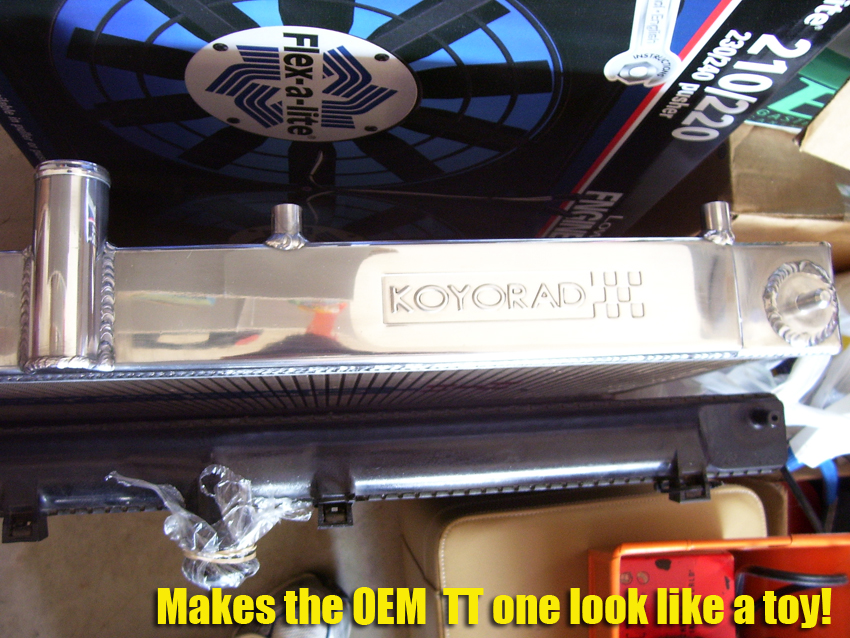

wow, koyo shines up their radiators alot more now i guess.

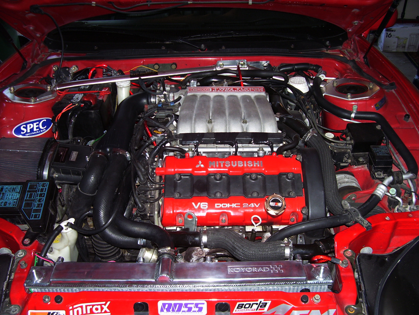

Ground wires installed.
New radiator installed.
WBO2 spliced and re ran
New fan controller installed.

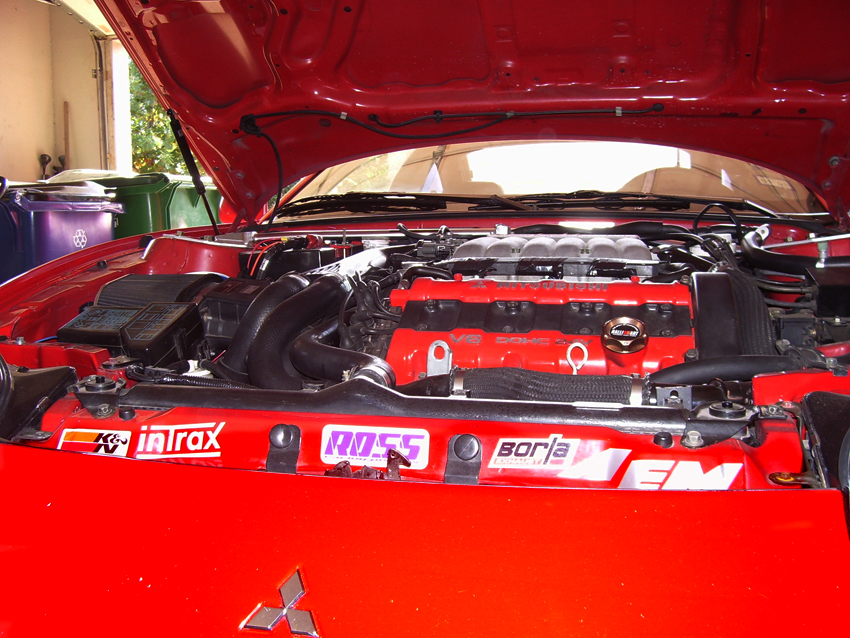

car completely put back together. (with exception of radiator brackets, those are on their way)
She started up and ran just fine, the fans kick on at temp and when the AC is on.
As of now the front turbo return line is not leaking. :D
