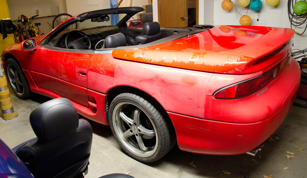

As most of you (that have been paying any attention) know, the Spyder's paint is terrible condition. The clear coat is chipped and bubbled all over the tonneau and faded elsewhere.
So Greg is selling his dip kit, and I'd like to jump on it, but I have several concerns.
1. Even with proper prep of the surface, will it look bad over the chipped clear coat?
2. With a thick enough coat, will the dip to peal off when we want it to (not stick and be a pita)?
3. None of their orange colors are exactly the orange we have in mind. Do these colors mix?
Any other thoughts?
Best pic I could find of the tonneau flaking.

I wouldn't worry about more clear coat coming off as it's screwed anyways and plasti dip comes off.....I say do it.

the surface should look fine, plastidip is thicker than paint, so the amount of coats needed to get good coverage would cover up any scratches or issues with the clear as long as you get most of the flaky parts off. it may peel off small parts that arent well adhered, but only in areas where its already flaking. i dont know if they mix.
That same color with copper metalizer over it may be close to what you are looking for

I'm worried about the clear coming off under the p-dip and causing blemishes or tearing. I couldn't care less about the actual paint on the car right now.
Ryan wrote:That same color with copper metalizer over it may be close to what you are looking for
The orange cars always look like sherbet. But that orange with copper may have just changed my mind.
It still seems like a huge pain in the ass though.

Buy a can of each and rattle a panel. Dont you have an old bumper somewhere?

Looks like it needs a fair amount of bodywork anyways. Anything the Plastidip would do to the paint wouldn't be anything near what's already happened to the paint.
For something temporary - I guess why not.
Long term though, a full strip down and repaint would be in order.

2. With a thick enough coat, will it peal off the clear coat?
Just realized my wording was not clear on this.
I don't care about the clear coat pealing off...I just want the dip to peal off when we want it to (not stick and be a pita).

i doubt it, its decently easy to peal off, but you still have to work at it
