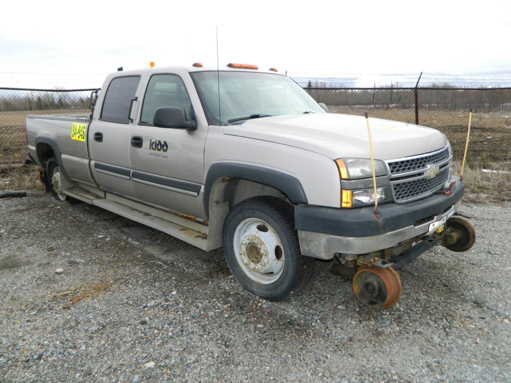

So this has been driving me nuts trying to figure it out. In my front bumper I have two notches on the bottom half of the openings, and behind that and attached to the frame are two what looks like hitch receivers.
You can see the notches here.
Any idea what this was used as in a past life? I don't think it was a plow truck as I have never seen a plow attached that way.

I was thinking tow behind personally because plows usually attach at the bottom.
Or maybe a construction vehicle that used something to hold cones or maybe a sign/traffic thing on the front? Like a wide load monitor truck or something.
Re: It's finally done
I thought for a minute it might be a hi-rail conversion, but those mount low like plows.
Who knows? I couldn't find anything even remotely like it on Google. Most of the flat tow stuff I found had clevis mounts instead of receivers.
