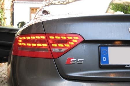

That's the thing. They weren't clear turn signals. They were reverse lights. Well, at least until I modded them.
So, here's what my original lights looked like.
The whole white strip across both pieces was a reverse light, and for the turn signal, the entire red area on the body would flash. The red light on the trunk was just a tail light. Not brake or turn.
The European cars on the other hand had it so the reverse light was the white one on the trunk, and then the white strip on the body had a yellow bulb inside. The red part was strictly for tail and brake lighting.
I ordered some yellow bulbs and changed the software config on my car so that it would work like the Euro cars. It looked better, but still not nearly as cool as the Euro LED setup. The US LED lights are all red. I got the Euro lights with the yellow LED turn, like the picture of the white car. I think these lights look great even when they're not lit.
Between tracking down the lights, finding part numbers for connectors and pins, wiring it all up and deciphering the crazy body control module configuration, this was not easy. Most people either buy an all in one kit for $800-1000 and either pay someone else to do their programming, or the kit will include a little automated dongle that programs the car for you. But sometimes those dongles can permanently mess up your body module.
So yeah....I figured out how to do it all myself a lot cheaper AND I understand how it works. I'm going to do a big write up for the Audi guys so that this shit isn't like some kind of state secret any more. :lol:
